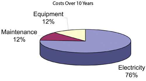

There is more to the purchasing decision than the initial first cost. The price of various compressor brands and models may differ by only a few hundred dollars, making the cheapest machine the obvious choice to the purchasing department, but examining energy characteristics can reveal additional hidden costs.
A 100-hp compressor requires about $37,000 in annual electrical costs at 10 cents per kWh with a five-day, two-shift operation of about 4200 hours per year. Over a 10-year period, these costs can represent about 76% or more of the total life cycle cost of the air compressor, with the purchase price representing only 12%. Because of this even a 5% change in operating efficiency can save you $18,500 in electrical costs over 10 years.

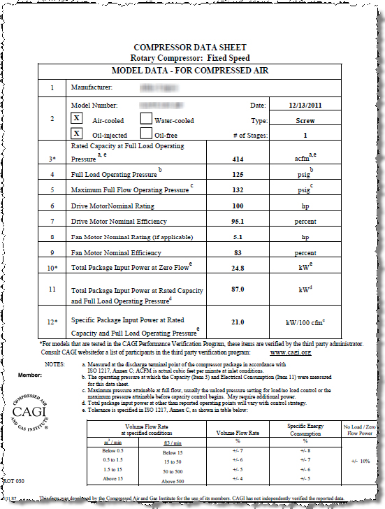

To do adequate power cost calculations some accurate and consistent information is needed so that true costs can be calculated. This can help you make appropriate decisions about energy efficiency. In past, information about air compressors was based on a variety of test conditions, but much of it was confusing and conflicting. Fortunately, CAGI Compressor Data Sheets are now readily available from participating manufacturers that show compressor and air dryer energy consumption in a standard format.
typical-cagi-data-sheet
Figure 2: Typical CAGI Data sheet for a fixed speed, lubricated screw compressor
Figure 2 shows sample CAGI data for a typical 100-hp, 125 psi air-cooled, fixed-speed lubricated rotary screw air compressor. Using this information, you can make estimates of the electrical needs of this compressor if its annual operating hours are known. Figure 3 shows comparisons of other compressors, one from the same company, and similar sized compressors from four other manufacturers. You can see the numbers vary, but the common ground is specific power. Specific power is like a gas mileage rating for compressors, showing the total package power input kW of a complete compressor package, including cooling fans, pumps, and other electrical loads for every 100 cfm of compressed air output.

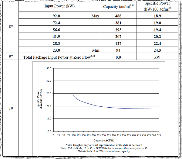

Evaluation of VSD power consumption
A new type of CAGI data sheet for VSD compressors has been recently developed for use by CAGI members. Figure 5 shows a table and curve from a sample data sheet for a 100-hp, 125-psi rated VSD style screw compressor.
Comparing this VSD curve with the numbers in Figure 3 shows this VSD unit would operate in the mid-range of the specific power numbers if it operated at 100% load. However, at 50% load it would have a very attractive number in the 20 kW per 100 cfm range, much better than a 31 kW/100 number for a partly loaded load/unload screw compressor following the 3 gal/cfm line in Figure 4. At lower percent loading the difference in efficiencies would be even more pronounced. This is the big benefit of VSD control, better efficiency at part loads.
The shapes of the various VSD curves can vary between compressors, with some units having very flat curves and smaller turndown ranges, while others may have wider but steeper curves yielding less attractive specific power numbers at lower flows. When comparing the energy consumption between various units the curve shape can make a significant difference depending on the actual compressed air demand so they shouldn’t be ignored. The new style CAGI Compressor Data Sheets for VSD compressors are valuable resources to assist you selecting the best option for your investment.

Option 2 One fixed speed and one VSD
This example uses Item A Option 2 in Figure 3 as base load and the VSD compressor from Figure 5 as trim. One compressor would be fully loaded at the higher flow with the trim unit covering the remaining flow of 148 cfm (600 – 452 = 148 cfm). This trim compressor would be 30% loaded. Energy consumption would be calculated as follows:
kWh = (cfm x specific power x hours)/100 = (452 x 18.2 x 3000)/100 = 246,790 kWh
For the trim:
Specific power at 30% load would be 21.8 kW/100 cfm from Figure 5.
kWh = (cfm x specific power x hours)/100 = (148 x 21.8 x 3000)/100 = 96,790 kWh
For the 200 cfm load:
Specific power of the VSD at 41% load (200/488) from Figure 5 = 20.2 kW/100 cfm
kWh = (cfm x specific power x hours)/100 = (200 x 20.2 x 2500)/100 = 101,000 kWh
Total for all hours = 444,600 kWh
Savings Option 2 vs. Option 1 = 612,310 – 444,600 = 167,610 kWh
At 10 cents per kWh, Option 2 would represent a 27% savings in electrical costs worth $16,610 per year over Option 1. Further savings could be gained by addressing other items like air dryers, filters, piping pressure drop, leaks and inappropriate end uses.
If Option 2 costs $20,000 more per year to implement, the return on investment would be slightly more than one year.
