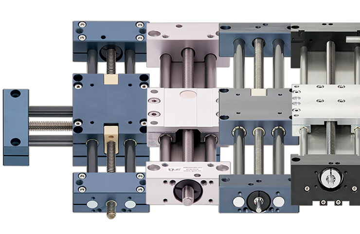

Lead screw-driven actuators—for high accuracy
If a lower speed, yet a high level of accuracy, is required, linear actuators with trapezoidal threads are usually a good option. The linear axes with lead screw drives are also great options for high axial thrust forces. Due to the critical speed limit for lead screws, the travel path (max. 1,500 mm/5 feet), the speed, and thus the speed of the lead screw, are severely limited. The recommended speed limit depends on the lead screw diameter.
With our dryspin® high helix thread, accuracy and medium speeds can be combined due to the special thread pitch; however, a maximum travel distance of 1,000 mm/39 inches must be observed.
When should I choose a lead screw-driven linear actuator?
  • For format adjustments
  • In extreme environments (heat, cold)
  • When corrosion resistance is required
  • When it needs to be low-noise
  • For shorter travels up to 1.5 meters or 5 feet
  • For low to medium speed with high accuracy

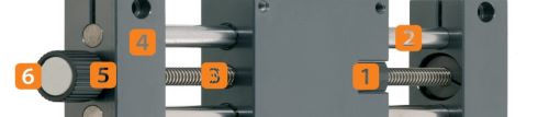

Structure of a linear axis with spindle drive
Linear axis with spindle drive
  1. Grease-free due to plastic bearings and plastic nuts
  2. Shaft material (aluminum, stainless steel, carbon)
  3. 8 trapezoidal thread pitches, 4 high helix thread pitches
  4. Base body made of stainless steel, aluminum, zinc or plastic
  5. Spindle machining according to drawing or spindle journal
  6. Accessories available

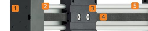

Structure of a belt-driven linear actuator
Linear axis with toothed belt drive
  1. Deflection with deep groove ball bearings
  2. Grease-free linear guide with plastic plain bearings
  3. Various sled lengths
  4. Polyurethane (PU) or neoprene timing belts
  5. Hard anodized aluminum
