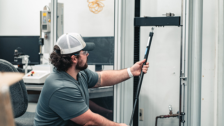

An engineer places a gas spring into a strut tester to determine what the compressive and extension forces are at the specific positions where the strut will be positioned in the application.

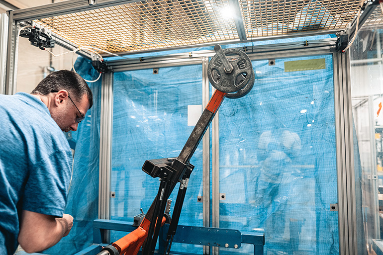

A cycle tester simulates various positions in a counterbalanced application. The fixed-mount positions can be adjusted up and down, and the moving mount positions are adjustable along the length of the arm (which is attached to the weights). The weights are typically used to simulate the mass of an application.

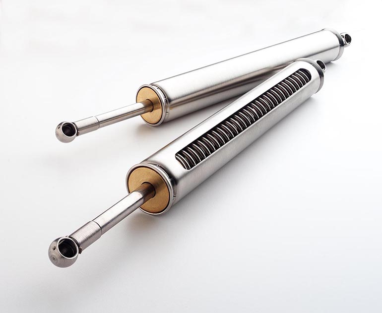

1. Mechanical. A seal-, gas-, and oil-less counterbalance solution that requires no maintenance and typically lasts the lifetime of the application. This choice is ideal in environments subject to corrosion or variable conditions, where failure is not an option. Mechanical struts can produce consistent, repeatable loads at varying intervals. This is the most environmentally friendly option.

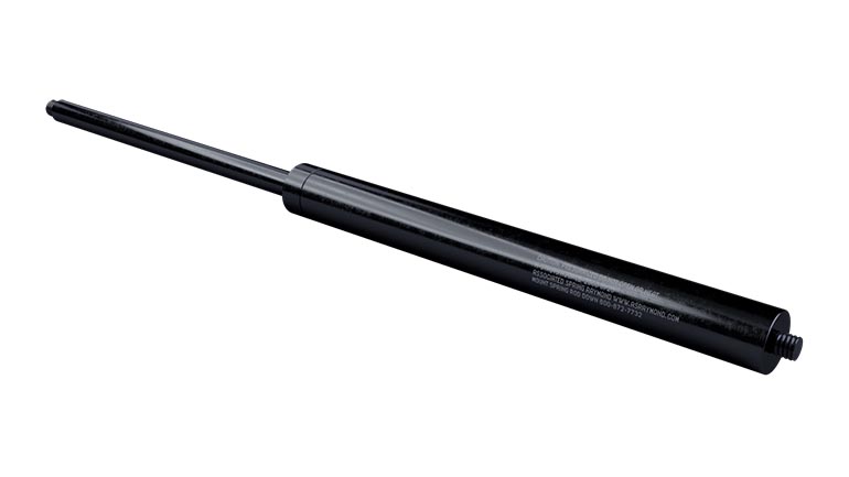

2. Gas. Gas struts consist of a precision rod attached to a piston, moving within a sealed cylinder that contains pressurized nitrogen gas and oil. They provide lift assistance and counterbalance to applications via a push or pull force that acts around a pivot axis.
“These are also referred to as gas shocks, and they’re a viable solution when the environmental temperature is stable. Because they’re closed, pressurized devices, this pressure can change in hot weather, for instance, and that changes the force output,” explains Rockow. “Corrosion can also be a concern, but stainless-steel versions are available, so there are solutions to mitigate certain conditions.”
It’s also worth noting that gas springs have seals that protect the oil inside, but these seals wear over time, so maintenance is typically required.
