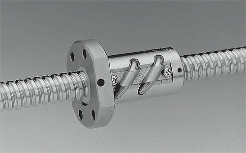

ball-bearing-screws
Ball bearing screws can be backdriven. A load on the nut will drive the screw because of the inherent high efficiency (90%). If backdriving is required in a particular application, the lead of the screw should be at least one-third the screw diameter. Ideally the lead should be equal to the screw diameter.
