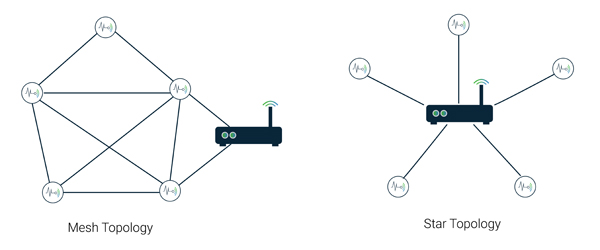

3. Network setup, management, and maintenance
Managing ten sensors and a thousand sensors are two totally different situations. The theoretical network capacity may sound impressive, but if it involves outrageously complex network configuration and management, manufacturers most likely won’t find the necessary IT competence to scale.
The choice of network topology can decide what will be required from a planning and administration effort. For example, mesh topology, widely adopted by short-range wireless technologies, can be much more sophisticated to manage than the star topology of wide-area solutions. Often times, mesh networks require installing extra devices that act as routers, not to capture important data, but only to achieve the desired coverage. Redundancy is hence an intrinsic part of these networks which can complicate management activities.
Figure 1: Mesh vs Star Topology.
Battery life is another critical aspect when it comes to device maintenance and scalability in practice. Maintenance costs account for a substantial proportion of Total Cost-of-Ownership in wireless sensor networks. Imagine how expensive and cumbersome it would be with a thousand field sensors deployed remotely and the need to replace batteries every few days.
