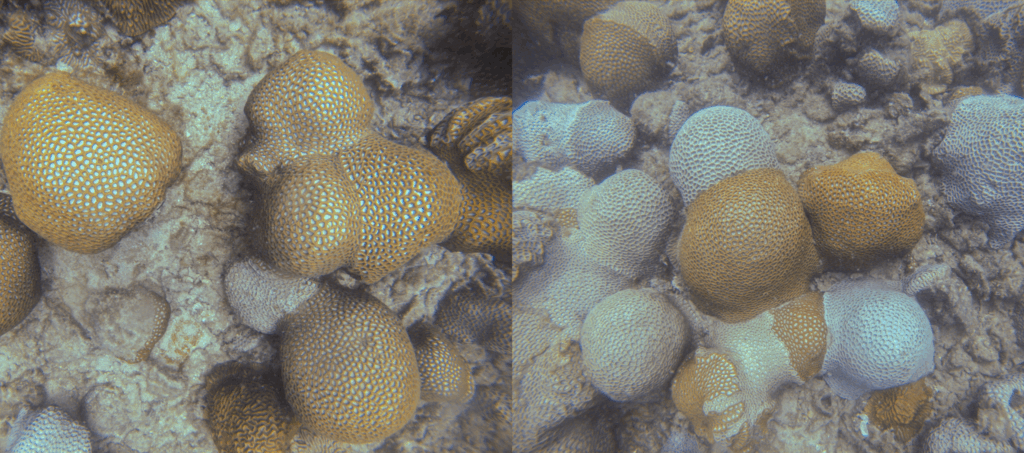

Advanced Navigation’s Hydrus unveils effects of coral bleaching at Hall Bank reef ecosystem.
Using Hydrus, a micro hovering autonomous underwater vehicle (AUV), the teams conducted a detailed survey of the reef, capturing geo-referenced high-resolution imagery and 4K video in parallel. The data showed severe coral bleaching and fragmentation, laying bare a hidden yet escalating crisis at one of the world’s southernmost reefs.

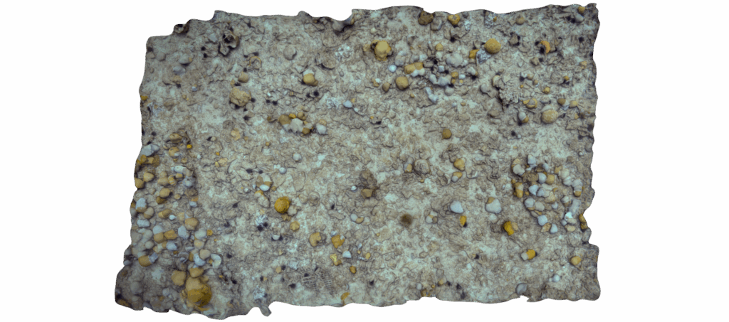

3D digital twin of Hall Bank seabed with data from Hydrus.
The data gathered from Hydrus was used to generate a 3D digital twin of the Hall Bank seabed. The model revealed a barren seafloor filled with pale, lifeless corals, documenting the shrinking coral formations.
This comes at a time when both of Australia’s two world heritage-listed reefs — Ningaloo and the Great Barrier Reef — were simultaneously hit by coral bleaching in March 2025, driven by an intense marine heatwave that drove sea surface temperatures up to 4°C above the summer average[2].

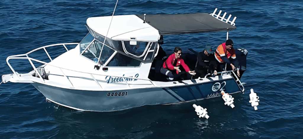

O2 Marine and Advanced Navigation deploying three Hydrus units at Hall Bank.
The mission involved the simultaneous deployment of three Hydrus units, each executing coordinated transects and lawnmower survey patterns across different sections of the reef.
This approach enabled comprehensive spatial coverage, ensuring overlapping, high-resolution data capture across the site. By flying precise, parallel tracks, the AUV was able to systematically map the reef’s structure and condition, capturing the fine-scale changes in coral health that are often missed by traditional survey methods.

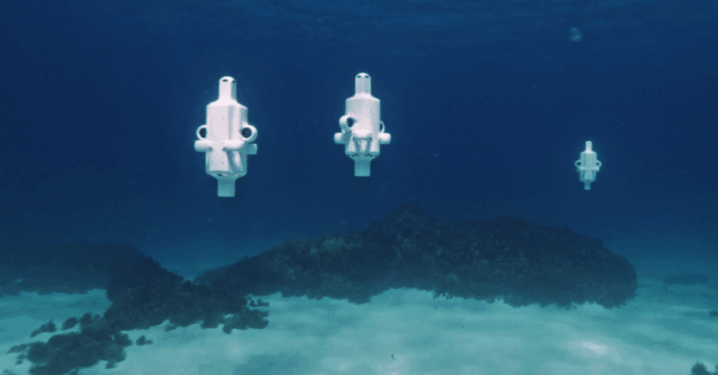

Micro hovering AUV Hydrus operating as a fleet at Hall Bank.
To unlock the ocean’s mystery and open it up for further scientific discovery, Advanced Navigation is appealing to the goals of the Seabed 2030 initiative[5] and the overarching United Nations “Ocean Decade” development plan[6], by working with partners to map the ocean floor.
