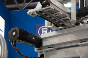

32803_SEW2220_Servomotor13
SEW EURODRIVE servo drives provide the XYZ gantry from Ilsemann Automation with coordinated movements. In the image: The motor for an axis in the retrieval system.

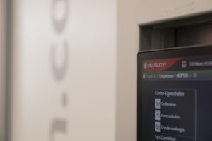

32803_SEW2214_Movisuite14
The MOVISUITE engineering software from SEW EURODRIVE is used for planning, startup, operation, and diagnostics. It reduces time and cost outlay for users and improves usability.
