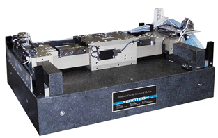

In general, since load-bearing capacity is proportional to area, air-bearing stages are somewhat larger than equivalent stages using rolling-element bearings. Finally, air-bearing stages are not particularly suitable for vacuum environments. The ABL9000 shows a cable management system with examples of vacuum, magnetic, and air-on-air preloading.

Ideally, air bearings should be mounted on granite bases. The granite can be readily lapped to a recommended flatness of 1 um per 50 mm and is very stable over time. The same tolerance holds when mounting accessories to the stage carriage. Three-point or kinematic mountings can be designed that work very well. Large format ABL9000 with travel of 1 m by 1 m. Cables are usually the biggest source of disturbance forces on air bearing stages. Stage manufacturers generally use high-flex cable for motor drive and encoder feedback, and can include extra conductors for customer use when discussed early in the design process.
