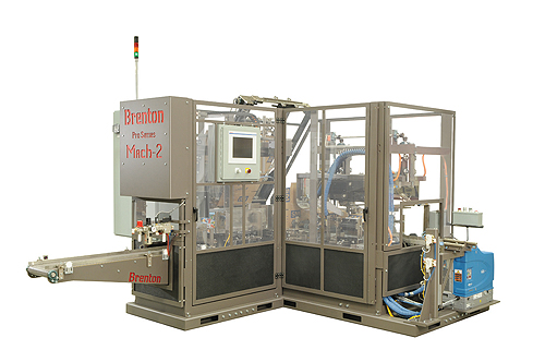

Brenton-packer
“We asked our customers how we could improve the machine. The feedback was to make it a faster and simpler all-servo machine,” said Mike Grinager, VP of Technology for Brenton Engineering. “With the new design we did everything we could to reduce the complexity of the machine. We took out the pneumatics, which was the most expensive aspect of the machine, and our engineers removed more than 200 moving parts, reducing costs by one-third. Plus, the integrated servo motors and drives that we now use require less space than even the smallest motors we used previously,” said Grinager.
As a result, the company’s BrentonPro Mach-2 case packer is an all-servo-driven, side-load case packer featuring an IndraDrive Mi integrated motor/drive platform with SERCOS distributed I/O, an IndraMotion MLC motion logic controller and the IndraControl VEP40 human machine interface all from Bosch Rexroth.
Brenton-ProSeries-Mach-2
The Brenton ProSeries Mach-2 uses a Rexroth integrated motor/drive and motion logic control platform to improve machine performance, save space, lower costs and save energy.
According to Grinager, the multi-axis machine reaches speeds of up to 25 cases/min and can accommodate a variety of cases, including RSC, HSC, tray, wrap-around, knock-down and harness for cartons, bottles, cans and tubs. During operation, an empty case blank is picked by vacuum and set in the machine. The case is moved through loading and sealing sections of the machine, which are powered by servo-driven flap traps. After loading, the full case is indexed through a compression and sealing area. The completed case is then discharged on the customer’s takeaway conveyor.
