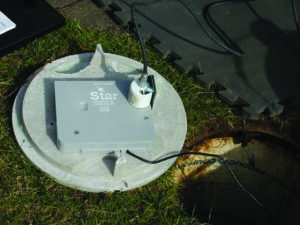

Extended battery operating life is essential to reducing the total cost of ownership of remote wireless devices, especially those deployed in remote locations and extreme environments, where the expense of replacing a battery far exceeds the cost of the battery itself.
Forty-year battery life is achievable for bobbin-type lithium thionyl chloride (LiSOSl2) cells, proven by AMR/AMI meter transmitter units (MTUs) manufactured in the mid-1980s. While being upgraded after 28 years of operation tests on the older batteries indicated a significant amount of unused capacity even after nearly three decades in the field.
Water and gas utilities depend upon these unique long-life lithium batteries to ensure robust network reliability, as any large-scale battery failure would disrupt monthly customer billing cycles and disable remote shut-off and hook-up capabilities. Fear of this worst-case scenario caused city officials in Springfield, MA to invest millions to replace tens of thousands of perfectly good meter batteries annually just to avoid the potential “chaos” that would have overwhelmed the city’s resources.
