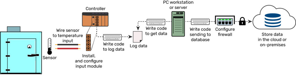

However, there are many obstacles to creating the level of integration required to fulfill that vision. Moving a single I/O signal from the field to the cloud requires a technology stack that includes many layers and involves many players. Each layer adds complexity, which affects the overall security and scalability of the system, not to mention added labor and cost (Figure 1).
Figure 1: Providing even basic equipment information to central business applications involves a complex hierarchy of software and hardware systems.

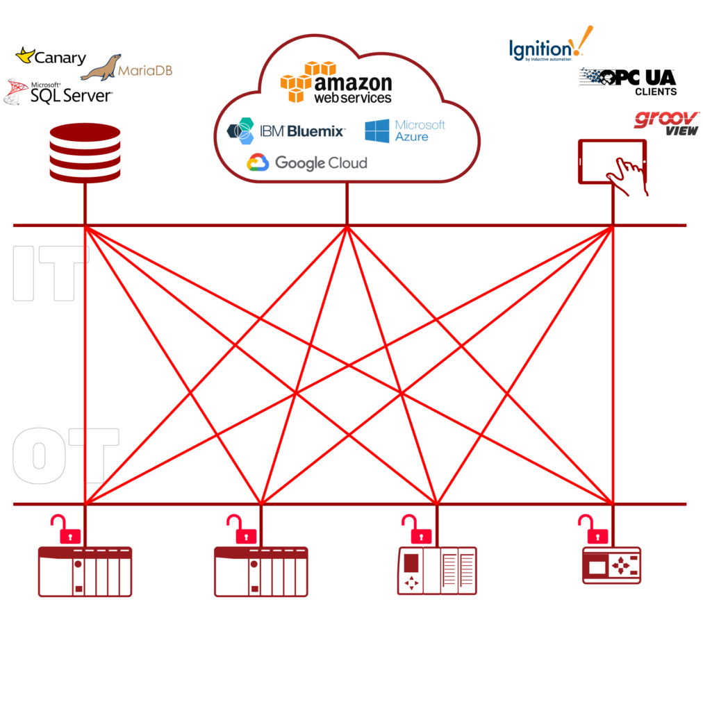

First, communication protocols themselves impose some limitations. Proprietary protocols, obviously, inhibit interoperability, even if the manufacturer supplies a client application for communication with their device. To enable true integration, the manufacturer needs to offer a custom communications driver that can be incorporated into other applications. However, even common industrial protocols, like Modbus/TCP or Ethernet/IP, have limited compatibility with IT systems—where data is in highest demand—and require further software and hardware support for integration. The most common approach requires the use of an open platform communications (OPC) server with drivers for each type of protocol in use on the plant network. No problem, right?
An unfortunate by-product of this model is that the more the network grows, the more congested it becomes. Poll-response communication protocols, like the ones mentioned, on control and corporate networks send frequent requests for information to maintain a sense of the state of the system and to act on the latest data. Additionally, business applications accessing field data through an OPC network may be competing with industrial SCADA (supervisory control and data acquisition) or historian applications on the control network for bandwidth, with each making its own connection to field devices and requesting the same data over and over again.
All these one-to-one connections also create security issues, for which traditional industrial protocols and equipment, like PLCs, lack native support (Figure 2). Additional equipment and networking, like VLANs and firewalls, are required to provide security after the fact. Unfortunately, with many different protocols in use, network protections become peppered with exceptions or become so restrictive that large-scale integration is impeded.
Figure 2: The typical industrial device contributes to the complicated web of unsecured, point-to-point connections that make up industrial networks.

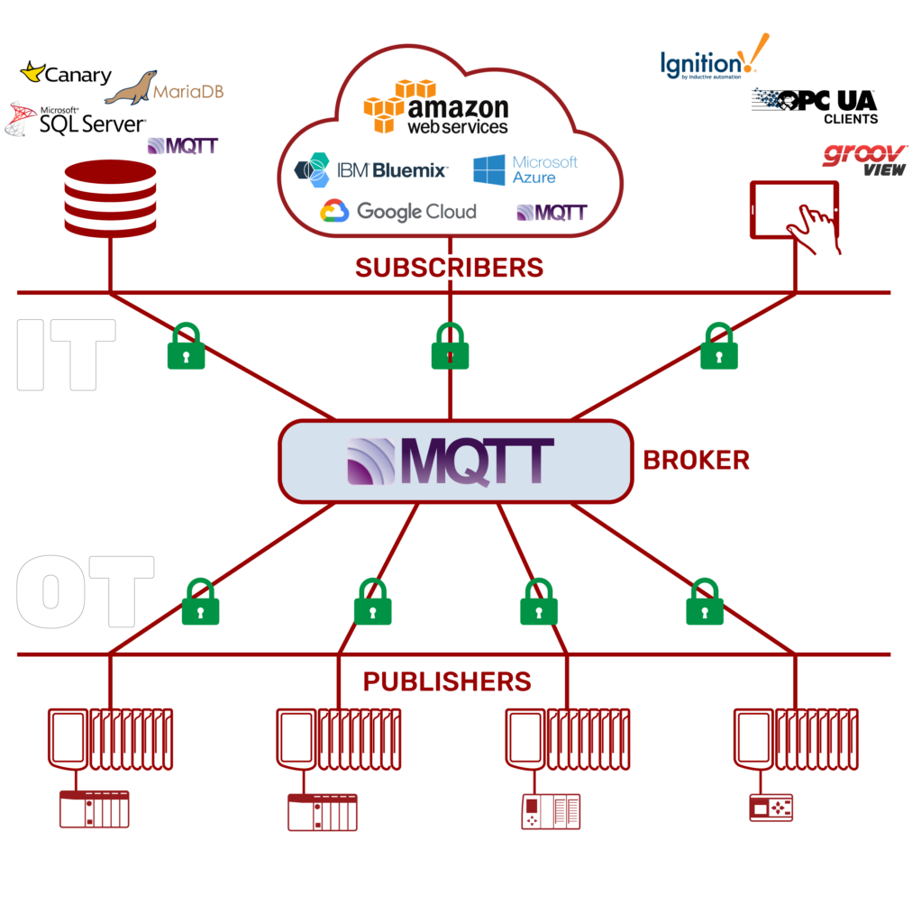

MQTT achieves this efficiency using a radically different communication model from other protocols used for industrial applications and IIoT. Rather than establishing multiple one-to-one connections between master applications and slave devices, and then polling those devices repeatedly for information, MQTT establishes a shared server, known as a broker, as the endpoint for all field devices and applications (Figure 3). Devices publish data to the broker, but they do so only when a change occurs in a given process variable—a feature called report by exception. Network applications can connect to the same MQTT broker, subscribe to updates from any device, and the broker will deliver them as they occur. If a device goes offline, the broker also delivers that notification to any subscribers.
MQTT creates a secure, highly scalable, many-to-many architecture for industrial applications and IIoT.
This publish-subscribe communication model allows for reliable, many-to-many communication with reduced network traffic overall, making MQTT the kind of scalable infrastructure that plant engineers are looking for.
MQTT is also inherently more secure than traditional protocols. With the MQTT broker as the single node in charge of routing all traffic, data access rights for the entire network can be managed in one location. And because MQTT connections are established by the device client, not the MQTT server, there is no need to create firewall exceptions for inbound MQTT traffic, even from outside the company network. With the addition of SSL/TLS encryption, MQTT traffic can be safely routed over public networks, and in fact, is the standard for all the major cloud IoT platforms, like Amazon Web Services, IBM Cloud, and Microsoft Azure.

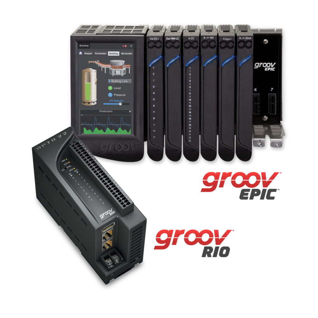

For manufacturers that use a dedicated gateway as a customer data interface, there are also MQTT-enabled controllers and I/O gateway options available (Figure 4). This approach can be used to combine communication functions with real-time control or visualization in one device, but it also has the advantage of tailoring data processing and publishing to end user requirements with greater ease. Where a firmware-based approach might require downtime to flash update memory, industrial controllers often support online editing.
Figure 4: As MQTT grows in popularity, more industrial devices are appearing with embedded MQTT publishing options (Pictured: Opto 22’s groov EPIC controller and groov RIO I/O gateway).
