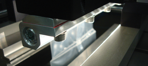

Branson ultrasonic components for Vertical Form Fill and Sealing (VFFS) systems by Emerson can seal directly through package contents, eliminating contaminants, reducing waste and weld failures for a wide variety of product packages.

Compared to the simple time, temperature, and force settings of a heated tooling sealer, the precise, programmable controls of ultrasonic welding technology provide the user far more capability to manage the narrower processing ‘windows’ of bio-based resins (see Figure 1). Ultrasonic sealing methods include weld-by-energy; peak power; and weld-by-time. Programmable amplitude provides fine-tune control of the heating potential from the resonating tooling.

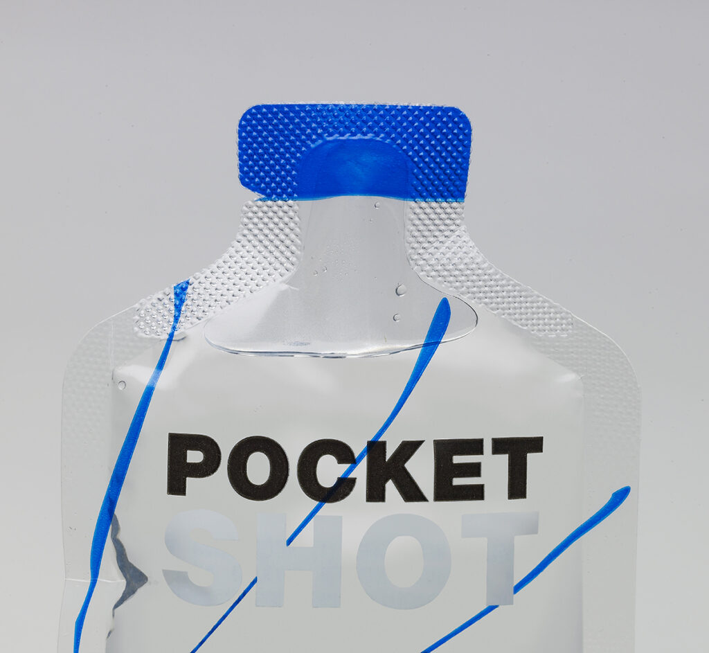

Pocket Shot, a 50-ml plastic pouch containing various spirits, is made of three-layer film with ultrasonically welded seals, providing a durable alternative to plastic bottles for people on-the-go.
The high-frequency vibratory motion (typically 20 or 30 kHz) of ultrasonic welding not only heats the sealing surfaces, but first vibrates potential contaminants out of the seal area. For example, with heated tooling seals particles of the product can get caught within the seal surfaces, potentially compromising the seal. With ultrasonics, the vibratory action cuts through any large pieces of a product (e.g., produce leaves) and also disperses smaller fragments and moisture out of the area of the seal. The result is less waste through rejects, improved seal quality, repeatability, and reliability.
