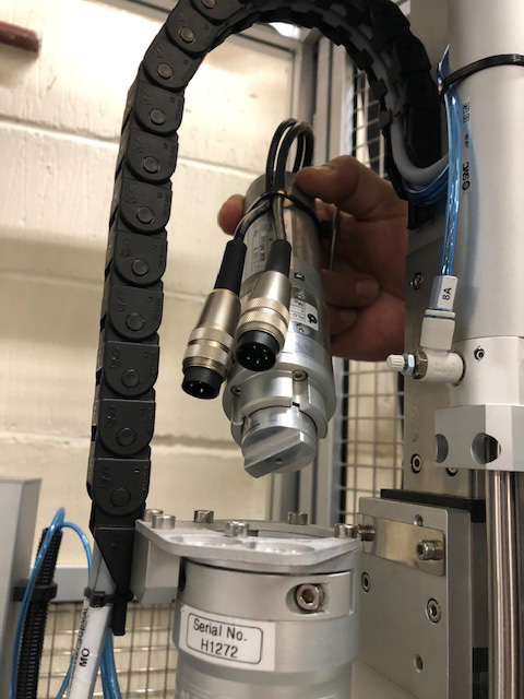

A key assembly of a machine is the capping head. The head must transfer power and control applied torque to seal the cap in position effectively. This precise operation must be conducted at great speed with total repeatability and reliability. Therefore, selecting an optimal coupling for installation between the drive motor and the capping head is especially important.
Proven performance
Cap Coder’s CC560 Capping and Filling Machine is one of its most proven designs, backed by decades of continuous development and user feedback. Able to accommodate containers from 25 ml up to 5 L, the machine can process up to 40 bottles a minute in operation. Versatility is built into the design, allowing for multiple capping processes to be supported within a single unit. Applications include screw cap, tamper evident, child resistant, trigger spray and pump action containers.
When it came to selecting a precision coupling for use within the CC720 Mk IV capping head fitted to the CC560, Cap Coder chose Huco’s flagship Oldham design. Featuring two hubs and a central torque disc, the Oldham matches precision with reliability. The version specified for Cap Coder features aluminum hubs and an acetal disc, delivering a peak torque rating of 9 Nm.
