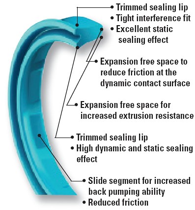

One example, which illustrates all four changes, is a newly designed U-cup seal.  This design increases the temperature capability and lowers friction compared to a standard U-cup.  The seal also contains a microstructure combined with back-pumping channels (see sidebar for definitions of specialized terms) on the dynamic seal-slide segment that ensure a constant lubrication film underneath the seal sliding surface and back-pumping across its entire pressure range.  This configuration reduces friction and thus temperature near the seal.
New Zurcon U-cup seal handles higher temperature and lower friction than standard U-cup.

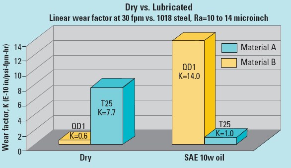

Sealing-system suppliers know that wear is a function of surface finish, running surface hardness, fluid, material, design, velocity, temperature, and loading.  The nearby chart shows test results on materials in two operating conditions, with the only change being the fluid conditions.  As the operating conditions change, the wear factor can be completely different, and thus the choice of material may change.
Wear factor on material under differing fluid conditions.

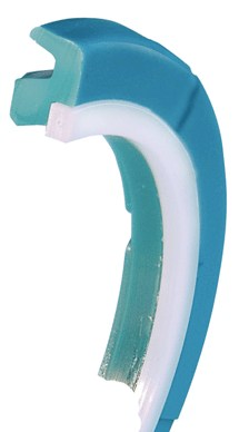

Buffer seal offers one way to counter pressure buildup.

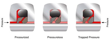

Another pressure-relieving seal. As pressure builds, the O-ring moves, allowing pressure to be relieved through the pressure-relief channel.
