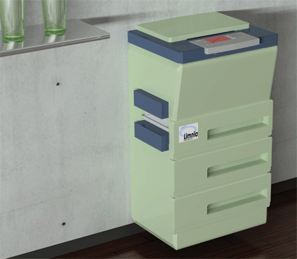

Limnia’s DECOM HomePack Personal Home Energy Plant.

A home pack, which comes with the system, re-charges the cassettes using two methods. The first is hydrolysis, which cracks the hydrogen. “If you electrocute water in a certain way with a certain type of salt, hydrogen bubbles out of the water. Limnia’s home pack uses the GE Noryl electrolyzer, which makes hydrogen cheaper than any other method out there – even gasoline,” said Redmond. The other way to produce hydrogen is via a microbial reactor. This consists of specially engineered bugs that eat waste to release hydrogen gas. Both sources of hydrogen are readily available. The home pack uses kitchen waste, as well as water to produce the hydrogen. Storage racks in the base of the unit hold charged cassettes for future use.
