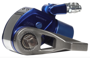

The award-winning MXT+ Hydraulic Torque Wrench has an embedded cycle counter to monitor tool use and schedule preventative maintenance and calibration. Learn more here.

The MXT+ Hydraulic Torque Wrench builds upon the best features of the original MXT Hydraulic Torque Wrench, adding the latest advanced technology — including coaxial reaction drive, auto-release feature, and a new cycle counter. The MXT+ Hydraulic Torque Wrench is constructed of higher strength materials, making it ideal for delivering highly repeatable performance during rugged industrial use.

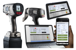

The Connect App provides Bluetooth-enabled wireless data exchange between HYTORC Electric Torque Tools and Windows PC or mobile devices. By sending preset bolting parameters to the tool, the app simplifies and speeds up the configuration of bolting operations. It guides users through simple or multi-pass sequential bolting operations to ensure job accuracy, and even records detailed bolting results for complete project documentation.

The MXT+ Hydraulic Torque Wrench is compatible with standard sockets, as well as the HYTORC Washer and HYTORC Nut, for safe, simple and precise fastening. It can accommodate rear-attaching and concentric reaction fixtures. When used with a HYTORC power pack, the system delivers +/- 3% accuracy. A concentric reaction spline decreases side-load and provides more uniform application of torque.
The MXT+ Hydraulic Torque Wrench is also equipped with a reversible square drive that allows users to change between tighten and loosen modes quickly, as well as a uniswivel coupler provides freedom in arranging tools and hoses.
A coaxial drive combined with rear reaction feature provide flexibility to configure the tool in the field, essentially replacing the need for two separate tools, while an integrated auto-release feature and new quick-couplers provide faster job setup and completion. The MXT+ Hydraulic Torque Wrench also features a new cycle counter that helps keep it in calibration, allowing users to schedule preventative maintenance for peak performance and longer tool life.
The HYTORC Connect App allows users to create multi-part, multi-pass bolting project procedures and execute them with the push of a button, by connecting to Bluetooth-enabled HYTORC Lion Gun Electric Torque Tools and Lithium Series II Electric Torque Tools.
An easy-to-use interface delivers the ability to execute even the most complex projects with onscreen guidance and automatic tool configuration for each pass. Users can customize items (wheels, flanges, joints, etc.), their count, number of bolts, and passes, and adjust settings — from basic to advanced — including torque and angle limits, units, user ID, flex options, shortcuts, rotations, release and fastener type, and more.
The Connect App receives detailed bolting results from the tool in use to monitor job progress in real time and collects and exports that data to a CSV file for saving and cataloging on a PC or tablet. By maintaining precise job documentation on every job, users can create their own comprehensive project data archives, including specific user-defined documentation fields. The resulting library of bolting profiles allows users to duplicate job parameters and send them automatically to the tool next time, reducing the potential for errors.
