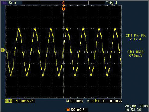

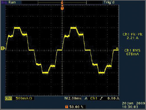

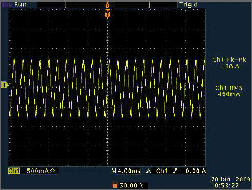

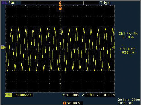

Bipolar drives supply stepper-motor windings with current waveforms that look like square waves when fully stepping or sine waves when micro-stepping at a high resolution. The waveforms shown in the oscilloscope displays illustrate the drive current in a half-stepping mode, which is two discrete steps for every pulse delivered to the stepper motor over a speed range of 500 to 4000 half-steps/s. Unfortunately, as the step rate increases, less voltage is available to supply the required winding current. This is because the BEMF (back electro-magnetic force) voltage increases, which, in turn subtracts from the supply voltage and limits the average (RMS) current during the ON time of the phase winding energized by the drive. At a critical step rate, the current fails to reach the set-point value, and the system behaves like a stepper motor powered by a voltage drive. The series of oscilloscope images show how the waveform continues to deteriorate at faster speeds: its amplitude decreases and progressively less current reaches the drive.
Oscilloscope Displays
The nominal current provided by the bipolar stepping drive is only available up to a certain speed (or step rate) of the stepper motor. After this, the motor’s inductance and BEMF limit the drive to a voltage drive. The BEMF (back electro-magnetic force) of the motor is voltage generated by the motor due to flux from the rotating magnetic field. Inductance limits the rate at which current builds in the winding and depends on the stack length and number of turns of copper wire used in the windings.
Fixed current is shown by the amplitude of the waveform: 1A/phase at 500 half-steps/s.
Deteriorating half-step waveform due to faster operation: 1000 half-steps/s.
Critical step rate determined: 3000 half-steps/s.
Less than 1A/phase at 4000 half-steps/s.
