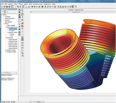

Students in this modeling project learned about temperature distribution in the engine block of a motorcycle.

Next came a half-hour discussion of the project details: to design the engine block for a V-twin air-cooled motorcycle engine. The rough specifications for bore, stroke, vee angle, and block material came from a Harley-Davidson engine. The students were to design a block that would stay at a temperature lower than 350º C while cruising at 60 mph.
The students’ real work started with an analysis on paper of a simplified block design, making a first guess at the number of cooling fins, their geometries, and sizes. Then, using assumptions and hand calculations, they arrived at a rough answer for the heat generation and dissipation from the running engine.
Then they moved to actual design. They drew the engine block and its cooling fins in SolidWorks. After they created the 3D geometry, it was brought into COMSOL using the CAD Import Module.

With the CAD geometry imported into COMSOL, they could then set up the model and generate a plot of the block’s temperature. Some students used the Heat Transfer Module while others simply modeled the steady-state heat conduction equation (Laplace equation) using the Coefficient Form. Whether a conventional or unconventional design, in about half the cases the modeling results were within 10º C of the hand calculations. In fact, comparing the hand calculations to the model results not only made them comfortable with the model results but also drove home the important lesson of not putting blind trust in them.
