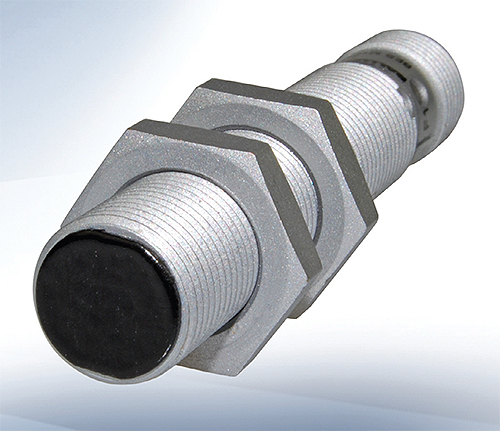

A ceramic based coating called SlagMaster® is used to repel weld slag on the face of this WFI sensor.

Welding Environments
The automotive body and frame industry, the “white goods” appliance industry, and other metal-forming industries employ many welding operations to produce a final product. These weldments include frame structures, body panels, and underbody support components that must be welded to properly form the subassemblies. Automated or manual “weld cells” create very hostile sensor environments due to high ambient temperatures, weld slag generation, part-loading impact, and the presence of strong electromagnetic fields. Uniquely designed inductive proximity sensors are made specifically to survive in this harsh environment. They have WFI (weld field immune) electronics, incorporate slag-resistant body coatings (such as PTFE), and have high-temperature-rated face materials (PTFE or similar material). The faces on these sensors tend to take the brunt of the welding abuse; therefore, some manufacturers offer optional ceramic-based face coatings to protect and extend the life of the sensor face. Many WFI sensors on the market also offer multi-metal detection at the same sensing range. These sensors are commonly referred to as Factor 1 or F1 models, since they have no sensing range reduction factor for non-ferrous materials like aluminum. Stated another way, their sensing range reduction factor would be equal to 1.0 (no reduction in sensing distance). Standard sensing models typically experience a reduction in sensing range for non-ferrous target materials. This sensing reduction varies per non-ferrous material and can be as much as 60% for aluminum. In this case, the sensor would have a reduction factor equal to 0.4 for an aluminum target. Factor 1 sensors do not have this limitation.
