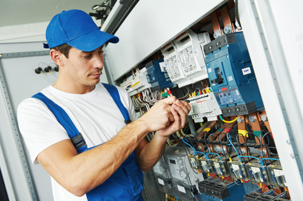

DIN rail-mounted industrial power supplies feed dc power to industrial components for industrial control, assembly, testing, and monitoring tasks — as well as other automation equipment that uses dc power. These power supplies are usually found in electrical cabinets and control panels connected to elaborate power and communication networks involving myriad components. Outside control cabinets, power supplies can also be found on machinery providing power to HMIs, motor drives, actuators, sensors, and more.
Control-cabinet image via Dreamstime

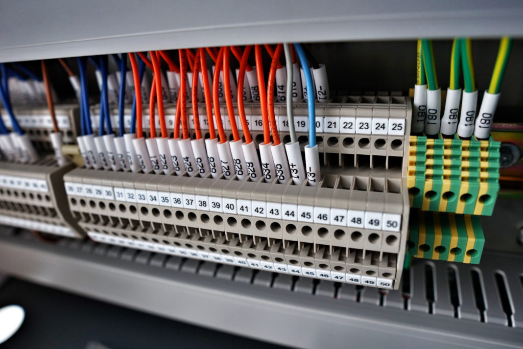

Terminal-block power-distribution image via Shutterstock

Power distribution and terminal blocks fall under the first category mentioned above — intermediary power components that don’t use power themselves. These blocks are used to distribute power from a single power supply to numerous industrial components.

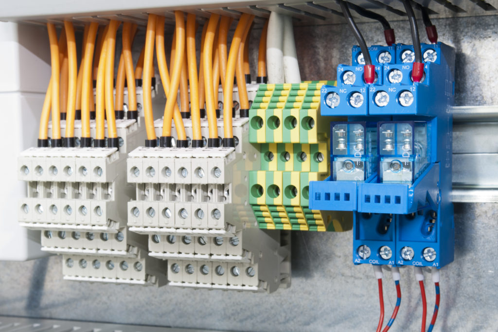

Mounted on this DIN rail are terminal blocks and (in the blue housings) relays based on electromechanical action.
Intermediary power components come in different sizes and have varying numbers of output terminals. In addition, power distribution and terminal blocks usually come with fuses connected to each terminal. The fuses may be rated differently … for terminals with different ratings. These components usually connect directly to the power supply from the power supply’s output terminals to their input terminal. They may also connect via an uninterruptible power supply or UPS.
