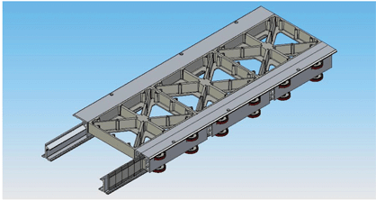

Most linear motors typically consist of a stationary motor with a moving magnet plate. The engineers flipped that idea, making the magnet track stationary and placing the motor coils on a moving platform. The engineers built a mounting for the magnet track and made a bogie cart with motor coils to ride on top of the track. The motors and magnets are common components, specified out of a catalog.
Maintaining air gap in a linear motor has always required special attention, even more so when it has to travel long distances in harsh environments. The Ward engineers solved part of this problem by using large diameter wheel bearings instead of ball-slide bearings. The recirculating bearings of ball slides often limit attainable travel speeds over linear distances. Paired with additional proprietary techniques, the wheel bearings helped maintain the needed air gap as well as reduced the need for precise installation of the rail guide. This component choice also enabled longer travel lengths. The initial design for the Post Office provided 2g acceleration with travel to 3g (50 ft/s/s) and positioning accuracy over an un-restricted distance equal to machine tool accuracy.
Replacing recirculating ball bearings with
large diameter wheel bearings helps increase system speed, maintain air
gap, and reduce the need for precise rail installation. The LTV can
reach a top speed of 1,375 ft/min.
