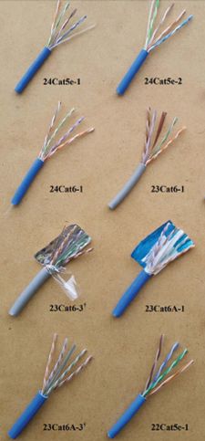

Concerns about PoE wiring resistance prompted the Dept. of Energy to investigate how much power is likely to be dissipated in PoE cable. Researchers at the Pacific Northwest National Laboratory (PNNL) measured the amount of power dissipated in the cable itself rather than in the PoE load. After evaluating nine different brands of Cat5e and Cat6 cable, DoE researchers concluded that energy lost in the cable stays below 5% of the total load in PoE lighting applications so long as the average cable length doesn’t exceed 50 m.
Cat5e twisted-pair cable has been the standard Ethernet cable for some time. But Cat5e has trouble handling the climbing data rates specified in next-generation Wi-Fi devices and Ethernet links. Specifically, Wi-Fi equipment on the drawing boards will transmit at data rates greater than 1 Gbps, possibly reaching up to 7 Gbps. Ethernet lines will hit 10 Gbps and higher. Cat5e can’t handle 10 Gbps speeds up to the 100-m distances called out in Ethernet specs. Cat6A cables with their larger 23 AWG wires will probably handle these high-speed applications.
Consequently, the PNNL group tested both Cat5e and Cat6 cables. As you might expect, the PNNL group found cables with bigger conductors exhibited less dc resistance. In general, Cat6 cables carry larger-gauge wire than Cat5e versions, though there are exceptions. ANSI C137.3, the standard for PoE lighting systems, recommends at least 24 AWG wire for PoE loads drawing less than 55 W and at least 23 AWG wire for higher-power four-pair PoE applications. In addition, several manufacturers market even bigger 22 AWG cables, both in Cat5e and Cat6, specifically for PoE applications.
The Cat5e cables in the DoE test carrying 24-AWG wire all had a rated dc resistance, called DCR, of less than 9.38Ω/100 m. Most Cat6 wires with 23-AWG had a similar rating though a few of them were rated to have less resistance, as low at 7Ω/100 m in one case. The 22-AWG Cat6 cable carried a 6.5Ω/100 m rating while the Cat5e cable with 22-AWG wire didn’t have a rating for dc resistance.
One concern PNNL researchers noted was that DCR ratings are maximum ratings. A few cable makers put out nominal resistance ratings, as well as a DCR, for their products. The nominal ratings can be significantly lower than the DCR figure and may be more helpful for calculating expected power losses.
