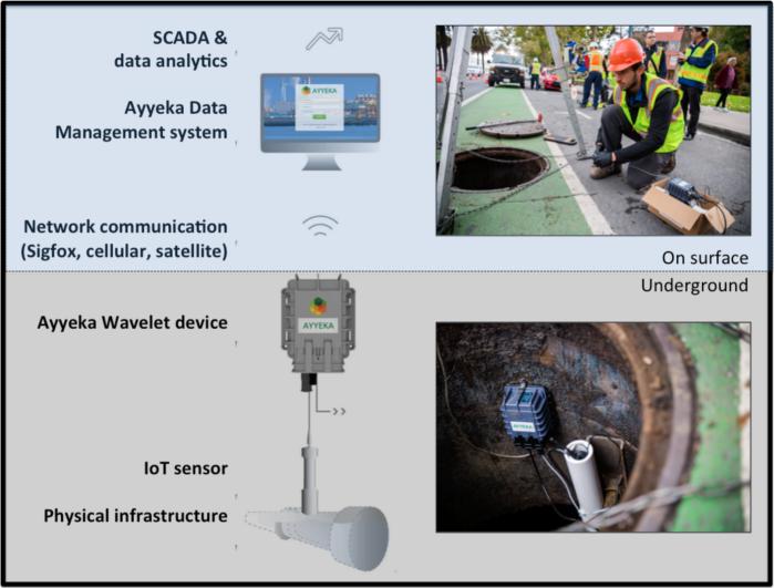

This was a prevalent issue in San Francisco and other large cities for a long time, however a procedure conducted by the San Francisco Public Utilities Commission (SFPUC) has alleviated some of these inconveniences. The SFPUC conducted a smart sewer pilot with the remote monitoring company Ayyeka to determine the effectiveness IoT sensors and other devices could have in the urban sewage maintenance of San Francisco.
(Image Credit: networkworld.com)
One of the biggest issues with San Francisco’s sewage system is the amount of seawater that seeps into the pipelines, which increases salinity and inductive conductivity levels. Using Ayyeka’s Wavelet Wastewater Quality Kit, workers can reveal the amount of seawater that’s entered the sewage system to determine the water’s conductivity.
The kit’s sensors detect the levels of three factors when making their measurements:
  1. Turbidity: when large numbers of individual particles (generally invisible to the naked eye) cause cloudiness in a fluid.
  2. PH Levels: the numeric scale (1-10) used to determine a substance’s acidity or basicity.
  3. Oxidation Reduction Potential (OPR): the water’s ability to break down contaminants and its overall level of cleanliness.
Using contactless radar and ultrasonic technology, the discharge kit can continuously monitor wastewater, while using hardwired sensors and wavelet devices to communicate over the Sigfox wireless (LPWAN) network to a hub. Sigfox uses a wide-reaching Ultra-Narrow Band (UNB) that frequently passes through solid objects. This is ideal for utilities since those solid objects usually entail layers of dirt and concrete, among other types of barriers.
The Ayyeka Wavelet uses two communicative channels; the first being Sigfox (for real-time communication), which is ideal for subterranean environments with low-power requirements. The second is cellular communication, which provides redundancy and allows data backup, along with remote configurations and upgrades.
Using a cellular or satellite connection, the hub communicates to the Ayyeka cloud, where data is integrated with SCADA systems or through an API with third-party software systems. Low-power Ayyeka devices in the pilot measure spikes in wastewater conductivity, along with tide conditions, while the SFPUC can set alerts to monitor wastewater quality and receive real-time notifications. This not only reduces the cost of labor, but also helps with regulatory compliance.
