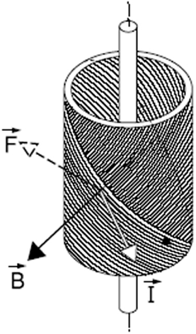

The name coreless (or ironless) refers to the motor construction. These motors, unlike most other types of motors, have no iron core-armature in the rotor. Special skewed or honeycomb patterns are used to wind the rotor coils to ensure mechanical strength and evenly distribute the magnetic flux for all coils in the rotor winding. This results in maximum torque and smooth rotation. Because it has no iron core to support the windings, they are typically held together by epoxy. Some designs use a plastic frame. Depending on the rotor geometry, ironless motors can be cylindrical or disc shaped. The stator is often made of ALNiCo, samarium-cobalt, or Neodymium magnets.
The commutators and brushes of smaller ironless motors are usually made of precious metals such as silver, gold, platinum, or palladium. They have low friction and generate little electrical noise. Larger motors often have copper-graphite commutation systems, which can handle high-density commutated current. Due to the absence of iron in the rotor, ironless motors have low winding inductance and thus lower levels of sparking between the brush and the commutator than conventional motors. Arcing normally produces electro-erosion and shortens the motor’s service life.
The hollow, basket-shaped rotor surrounds the permanent-magnet stator. The magnetic field with flux density B created by the stator interacts with the current I in the rotor winding creating rotational force F.

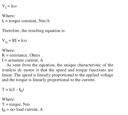

When the motor is voltage driven, the following equations contain detailed design parameters that are necessary to take full advantage of the coreless technology.
An ironless rotor motor can be represented by the following simplified diagram:
The voltage induced in the rotor (back EMF) is proportional to the angular velocity of the rotor:
Where:
Motor manufacturers normally specify three constants: back EMF constant, torque constant, and velocity constant. If these three constants are expressed using the proper units their values are equal. So, substitute the torque constant for the back EMF constant in the equation.

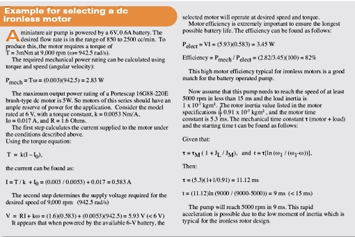

Calculating Mechanical Power, Electrical Power, and Efficiency:
The electrical power applied to the motor equals the mechanical power produced by the motor plus the power dissipated as heat. At a given input power, more mechanical power becomes available to drive the load as the losses diminish.
At a given input power, more mechanical power is available to drive the load as the losses diminish.
The motor efficiency is defined by the ratio of the mechanical power and the electrical power:
The Torque-Speed Curves graph is a visual representation of the interdependency of various motor characteristics. It shows motor efficiency, speed, mechanical power, and armature current as functions of torque. The three speed curves were plotted at different supply voltages and show linear dependency between the supply voltage and the speed. The following observations can be made:
• The current is proportional to the motor torque.
• The speed is proportional to the supply voltage.
• The maximum efficiency occurs at high speed.
• The mechanical power reaches its maximum when the load torque is equal to half the stall torque.

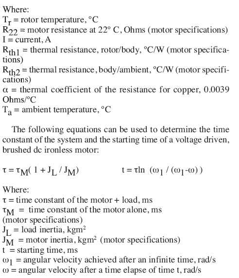

To ensure long service life the maximum armature temperature must not be exceeded. For example, the maximum rated coil temperature of a certain motor is 100° C. The equations below show how to determine the rotor temperature.
This is a visual representation of the interdependency of various motor characteristics. The X-axis represents the torque. The efficiency, power, current, and speed axes are aligned with the Y-axis.
