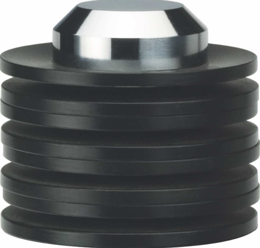

A stack of disc springs. Unlike Belleville washers, disc springs are designed to provide a repeatable force-travel relationship and are superior for use in dynamic applications.

Disc springs have a conical shape with a slight curvature. They consist of one or more stacked conical discs, each with a hole in the center. The outer edge of the discs is typically flat, while the inner edge is curved. They can be used as a single piece or stacked in a series or parallel to achieve the desired load and force-deflection performance. Stacking multiple discs makes it possible to adjust the overall stiffness of the spring system.
Unlike Belleville washers, disc springs are designed specifically to provide a repeatable force-travel relationship. They have a long and predictable fatigue life in dynamic or cycling applications. Disc springs can be statically loaded continuously or intermittently, or dynamically subjected to continuous load cycling.
