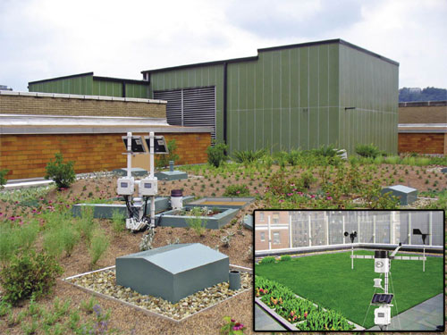

Onset Computer Corp., a supplier of data loggers and weather stations, recently announced the HOBO Green Roof Monitoring System, a research-grade system for measuring the performance of green roofs. HOBO provides reliable performance in harsh rooftop conditions—the 15-channel system enables users to quickly and easily monitor green roof conditions, measure stormwater runoff, improve irrigation scheduling, and maintain healthy rooftop vegetation.
GreenRoof_05_2_opt
Key advantages of the system include:
  • 24/7 web-based access to data
  • All common green roof measurements: temperature, relative humidity, wind, soil moisture, light intensity, rainfall
  • Plug-and-play sensors that enable easy deployment
  • Customizable data display for kiosks
  • Trend logging, monitoring, and alarm notifications
The system includes a HOBO U30 GSM-cellular data logger with one-year service plan, Smart Sensors for measuring rainfall, soil moisture, soil temperature, solar radiation, air temperature/relative humidity, and wind speed and direction, as well as mounting brackets and a 6-Watt solar panel. Optional mounting masts, tripods, graphing and analysis software, and additional sensors are also available.
