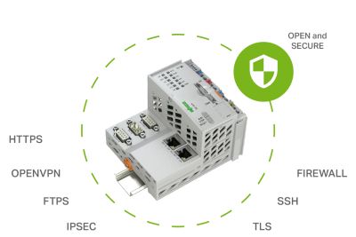

Part of the problem is that the original development of widely used fieldbus protocols, which took place long before the advent of the internet, proceeded with no thoughts about security. Those systems were designed for ease-of-use and operational reliability which often led to the creation of vulnerable access points for external attackers.But that doesn’t mean modern industrial networks can’t be rendered close to bulletproof. To get an idea of what’s possible, consider the security measures implemented by Wago’s PFC family of controllers. Security techniques that PFC100 and PFC200 controllers implement can serve as examples of the safeguards modern industrial networks can employ.
“Our devices have security measures built-in that are unlike those of other products on the market,” Charlie Norz, Wago Automation Product Manager said. “We have a built-in firewall to separate networks; in addition we also have built-in VPN that support two different types of VPN technologies that users can add to their controllers to enhance security. When sending information to a cloud, for example, we also have a TSL 1.2 security that can transfer data via HTTP. So we add a lot of features right within the controller so that users don’t have to add additional components in their network.”

Standard security measures, like firewalls, password protection and individual user rights, protect data within each location from unauthorized access. Wago’s PFC100 and PFC200 controllers transmit data through onboard TLS 1.2 security protocols and also securely transmit data to the cloud.
A virtual private network extends a private network across a public network and enables users to send and receive data across shared or public networks as if their computing devices were directly connected to the private network. The Wago PFC controllers support the two common protocols that are used to set up VPN Connection, OpenVPN and Ipsec. (IPsec, for IP security, is a suite of protocols developed to ensure the integrity, confidentiality and authentication of data communications over an IP network.) This means there is secure communication over an insecure network.
An Open VPN connection can be applied straight from the PLC through data that is sent encrypted with the VPN directly on the PFC100 and PFC200 controllers. Communication is secured by encrypted VPN connection using MQTT and other protocols.
MQTT (MQ Telemetry Transport) is a publish/subscribe, simple messaging protocol designed for constrained devices and low-bandwidth, high-latency or unreliable networks. The design principles are to minimize network bandwidth and device resource requirements while simultaneously attempting to ensure reliability and some degree of assurance of delivery. These principles make the protocol useful for Internet of Things connected devices and for mobile applications where bandwidth and battery power are at a premium.
To ensure information security and integrity during web access and data transfers, the TLS 1.2 encryption method is used as the standard for establishing secure HTTPS and FTPS connections, and the SSH protocol is integrated as standard for establishing secure shell and SFTP connections.
“TLS Security is used for transporting HTTP and is an industry standard for communication,” Norz said. “It is important when connecting data from a plant floor to the cloud. With our controllers we have the ability to publish and subscribe to MQTT brokers, which is becoming an industry standard for cloud technology and even more recently we have Sparkplug, which is also MQTT-based and through both of those protocols we are able to enable TLS security. If you are sending data, the data is encrypted so no one can read the data even if they capture the communications.”
With a standard integrated firewall, Wago’s PFC100 and PFC200 controllers protect against unwanted network attacks. There is no need for encryption via external components and protection through external firewalls. Firewall protection is out of the box without the addition of external devices.
Linux software is the foundation behind these security mechanisms. Because the Wago controllers are based on a Linux system, the security is essentially built-in. The Wago controllers also have physical network segmentation via VLAN so application levels and management levels can be separated safely from one another.
