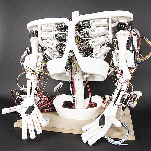

Roboy-Torso
The torso of the Roboy robot developed by the Artificial Intelligence Laboratory at the University of Zurich. The entire robot uses more than 50 brushless dc motors combined with gearheads and encoders from maxon precision motors.
