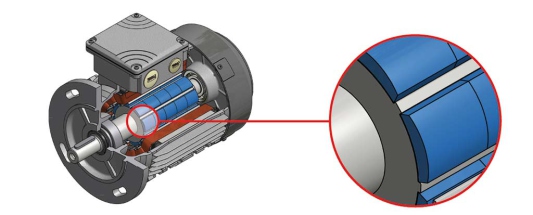

What’s more, the motor’s high power density allows for a frame size that’s up to two sizes smaller than traditional designs. That’s thanks to a design with surface-mounted permanent magnets (SMPM) on the rotor.The design trims dimensions and weight by 50% compared to other aluminum-bodied motors. The assembly includes premium shaft bearings to accommodate the high power density. There’s also higher space and weight savings than EISA Premium Efficient motor designs with rolled-steel or cast-iron construction.
