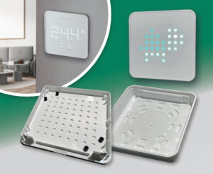

OKW has introduced a new machining service for LED backlighting as part of its enclosure customization options. This service addresses ingress protection challenges of fitting LEDs and light pipes to a housing’s front panel.
The backlighting solution enables designers to add visual indicators to their devices. Numbers and letters appear only during illumination and remain invisible when LEDs are off. This functionality is achieved through precision machining of small indentations into the underside of a panel, allowing light from LEDs to pass through while maintaining the enclosure’s designated IP rating.
The technique works by mounting LEDs below the panel surface according to customer specifications. The machined indentations are calibrated to a thickness that permits light transmission through the plastic while remaining visually undetectable when not illuminated.
