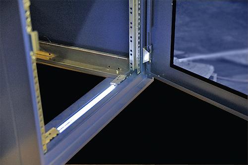

Light tubes can be used inside electronics like this cabinet enclosure to provide low-power illumination in various shapes and lengths. With a rugged and reliable design, the tubes are particularly beneficial in electronicsapplications for railway, seismic zones, military/aerospace, mobile, and more.
