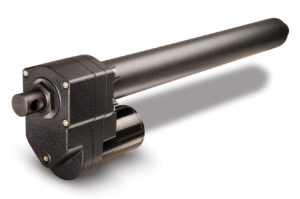

The standard designs of these Altra Motion actuators provide load capacities from 200 – 20,000 Newtons and are usually specified for heavy duty applications.

The actuators operate efficiently thanks to an electric motor combined with a high-efficiency gear train, hardened as standard, and a ball screw and ball nut drive. These components are durable and require little maintenance, which ultimately reduces their lifetime costs and improves productivity. The standard designs have load capacities from 200 – 20,000 Newtons and are usually specified for heavy duty applications. The overall construction of the actuators minimizes any maintenance requirements and provides a reliable component capable of performing in harsh operating conditions.
Linear actuators are well suited for the most demanding applications where an alternative to hydraulic or air cylinders is needed. This functionality is achieved by creating seal designs that have enabled all of Warner Linear’s actuators to have an ingress protection rating of IP69K when static and IP66 when dynamic. The lesser-known IP69K rating ensures that equipment is suitable for wash down with high pressure, high-temperature water.
