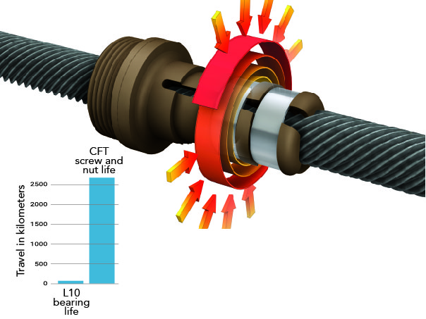

Traditional anti-backlash nuts use a multi-piece design that requires a coil spring to move a collet linearly along the nut to close the fingers and control the fit between screw and nut.
Problems that contribute to failure in these designs are the sporadic and variable force of the spring, stick-slip of the collet on the nut, and fluctuating pressure as the nut material wears. In contrast, one alternative nut designed to deliver constant force includes a simplified two-piece design that applies pressure to the nut fingers in a radial fashion which is the direction needed to control clearance or play between the nut and screw.
Shown here are a conventional coil spring and collet anti-backlash nut Design and a Constant Force Technology (CFT) anti-backlash design patented by PBC Linear. The latter is tested in excess of 2,500 miles travel without failure … for forty times the L10 life for the axis.
Consider the conventional coil spring and collet design for an anti-backlash leadscrew nut. Here, a variable force coil spring generates axial force which is converted to radial force through mechanical interference. The design relies upon injection molded components to apply force equally to the fingers. Benchmark testing confirms that preload changes dramatically in the first 1,000 cycles.
In contrast, certain constant-force anti-backlash leadscrew nuts provide backlash performance that’s two to four times better than conventional designs as validated by lab automation customer’s FDA testing. A constant force spring design ensures consistent pre-load over the life of the axis. Self-lubricating nut material with PTFE for lubricity and enhanced efficiency.
System testing utilizing laser interferometers validate accuracies and can provide screw mapping capabilities to aid in the final system integration.
One of the biggest advantages of constant-force anti-backlash leadscrew nuts is their capability to be tuned to an application with adjustments to the spring and other parameters. This tuning allows for the optimization of preload, backlash, drag force and running clearance to meet the specs required. Each screw and nut combination, along with each full up motor and screw assembly, can be tested for each of these performance characteristics during validation and final inspection.

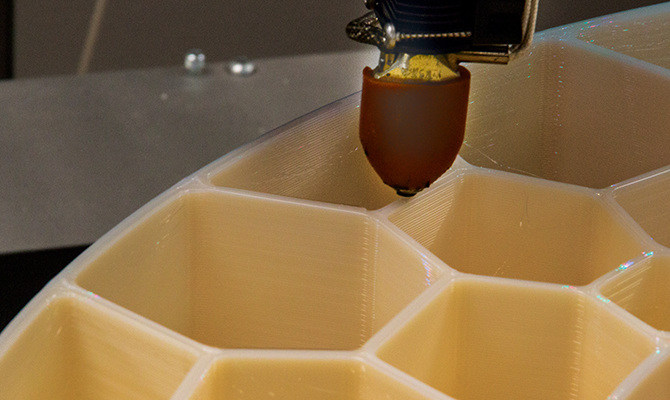

Case study —X-Y contouring and dispensing: A fused deposition modeling (FDM) 3D printer tends to produce a part that shows ridges or the beads from each layer as it is placed on the printed part. Working with an FDM machine builder and using the consistent performance of the constant-force anti-backlash nut features, engineers were able to decrease the surface finish and layer resolution of prints while using the control commutation capabilities of a smart step-servo motor to improve performance resulting in twice the process output of a typical FDM printer.
