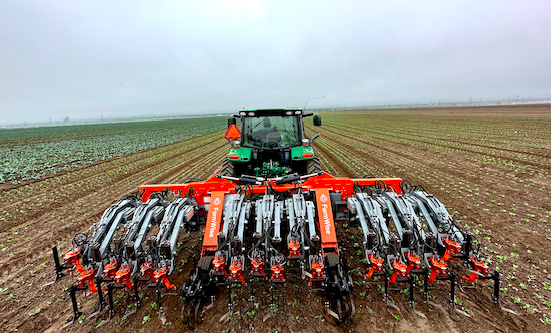

PBC Linear slides are a key component of FarmWise's Vulcan intra-row weeding implement. The slides provide precise height adjustment for the weeding tool, ensuring that the tool is always at the correct level to remove weeds without damaging crops.

The weeder module has two translation axes, including a hydraulic z-axis actuator, allowing it to move up to a dozen inches or so vertically. A feeler wheel arrangement locates the weeder module relative to the crop surface and informs it of changes in the bed’s topology. The balance between automation and user control, however, was critical to the success of this application, according to FarmWise senior mechanical engineer David Olivero.
“While the goal is to maximize automation, we acknowledge the farmers’ expertise,” Olivero explains. “Farmers understand the optimal depth for weeder blades to effectively remove weeds while avoiding root damage, and we wanted to empower farmers by allowing them to adjust blade depth according to their preference for deeper, more effective weeding or shallower weeding to protect crop roots.
To achieve this flexibility and reach in the z-axis, FarmWise specified UGA Low Profile Uni-Guide with a custom-positioned hand brake from PBC Linear. Up to 18 of these slides, located at the back of the implement, add a few inches of vertical travel. This addition extends bed capabilities and accommodates varying soil types. The slides offer a robust and customizable solution to adjust the system’s height, enabling it to cater to various farm configurations and terrains.
“We appreciated PBC Linear’s customization platform, which allowed them to create a slide with a specific mount offset tailored to our unique requirements,” says Olivero. “The low-profile design of the slides was vital to reduce the cantilever length of the weeder module, mitigating the risk of transport shock during field-to-field movement. PBC Linear’s reputation for quality products and ease of customization made them a preferred choice.”
