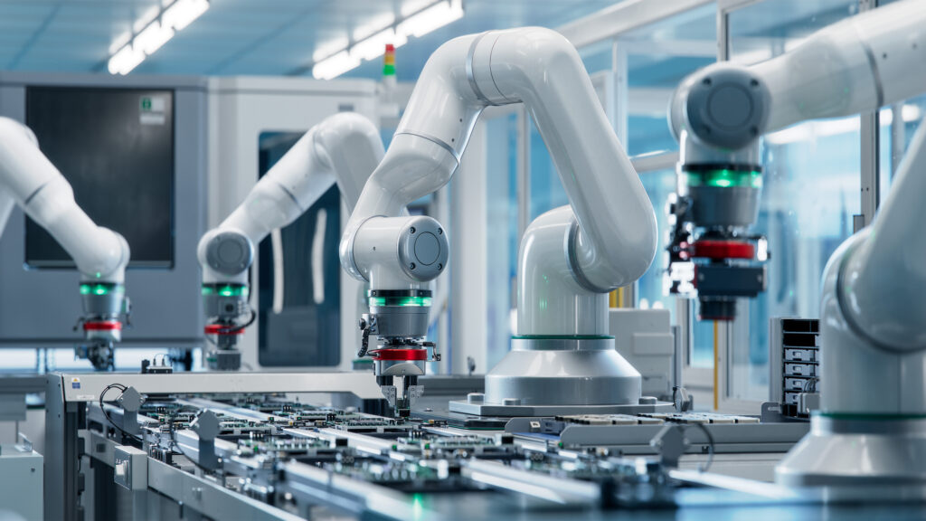

In the context of discrete automation, extreme can refer to environmental requirements — as those of cleanroom applications, for example. Image: Adobe Stock

A good example of an extreme environment is a cleanroom setting, which are categorized into different classes and have very specific requirements based on the particles that are emitted from all processes. Cleanliness is of paramount concern in cleanrooms, so the use of corrosion-resistant steel is preferred. That’s because the material prevents the release of particles that would otherwise occur with incipient or progressive corrosion. The faster a process moves, the more turbulence and friction are created, which can increase the number of particles that are emitted. A similar effect is seen with payload — the heavier the load that’s transported, the more particles are released.
