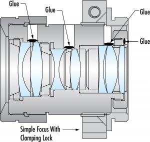

Figure 1: Edmund Optics Cr Series Stability Ruggedized lens with all elements glued in place.

Stability ruggedization
Some of today’s more demanding applications in factory automation, measurement, robotics, and autonomous vehicles levy additional requirements on imaging systems beyond those of Industrial Ruggedization and Ingress Protection Ruggedization. In such situations, there’s another type of ruggedization: Stability Ruggedization. The Edmund Optics TECHSPEC Compact Ruggedized (Cr) Series Fixed Focal Length Lenses are an example of Stability Ruggedized imaging lenses.
While Ingress Protection Ruggedization prevents contamination and Industrial Ruggedization eliminates moving parts, Stability Ruggedization maintains (or stabilizes) optical pointing and positioning even after heavy shock, vibration and temperature change. In a Stability Ruggedized imaging lens, the individual lens elements are glued into place to prevent them from moving within the housing (see Figure 1).
In an optical system, lens elements sit within the inner bore of the barrel. The space between the outer diameter of the lens and inner diameter of the barrel is typically less than 50 microns; decenters of even tens of microns are enough to significantly affect the pointing of the lens (see Figures 2, 3, and 4).
