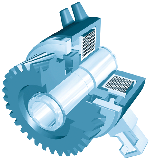

Electromagnetic clutches
Electromagnetic clutches tend to excel in performance for another six of the 16 possible characteristics:
• Random start/stop
• Power-on and power-off braking
• Soft start/stop
• Bi-directional rotation
• Speeds exceeding 1750 rpm
A simple electromagnetic clutch is a device that connects a motor to a load. Generally, the motor shaft is pinned or keyed to the clutch rotor-shaft assembly bore (input) with the load
connected to the armature (output) of the clutch with a pulley or a gear, figure 2.
Fig. 2 — Electromagnetic clutch. The armature is normally decoupled and free to run until the coil energizes. When the magnetic field is generated, the rotor-shaft assembly attracts the armature plate, engages with the rotor assembly, and drives the load.
Before the coil energizes, the armature assembly does not couple, so it cannot rotate with the input rotor shaft. When the coil energizes, however, the rotor shaft assembly becomes part of an electromagnet, attracts the armature plate, engages this with the rotor assembly, and drives the load. When the coil de-energizes, the two elements no longer attract and a spring within the armature assembly separates them. The motor shaft and load disconnect so the load cannot be driven. The clutch lets the motor run while the load idles, which decreases cycle times and yields better overall system efficiency.
Clutch couplings also connect two parallel shafts with pulleys, gears, or sheaves. Although an anti-rotation tab or flange prevents the field (electromagnet) from rotating, the rotor and armature assembly mount on a single shaft with the rotor secured to the shaft. The armature mounts through bearings and rotates freely. When the coil energizes, the armature engages the friction surface of the rotor and drives the load. Electromagnetic clutch couplings provide the same efficient, electrically switchable link between a motor and a load for in-line shafts. Here again, an anti-rotation tab or flange prevents the field assembly from rotating, and the rotor and armature assembly securely mount on opposing in-line shafts. When the coil energizes, the armature engages the friction surface of the rotor, couples the two in-line shafts, and drives the load.
Power-on brakes operate under the same principle as the clutch, but with only a single rotating component, the armature assembly, figure 3.
Fig. 3 — Power-On Electromagnetic Brake. The armature assembly rotates freely until the coil energizes, attracts the armature plate, and brakes the load.
The brake is generally positioned on the load shaft with the armature assembly secured to the shaft and the field assembly is mounted to a non-rotating component or bulkhead. Before the coil energizes, the armature assembly rotates freely. When energized, the field assembly becomes an electromagnet, attracts the armature plate, and stops the load.
Power-off, spring-set brakes operate under a slightly different principle, figure 4.
Fig.4 — Power-Off Electromagnetic Spring-Set Brake. Compression springs normally apply the braking force. In power-off mode, the springs apply pressure to the armature plate, which, in turn, applies pressure to the rotor. When the coil energizes, the brake spline decouples from the load shaft and the load rotates freely.
Compression springs within the field assembly apply the braking force. In the normal power-off mode, the springs apply pressure to the fixed (non-rotating) armature plate, which in turn applies pressure to the rotor. The rotor can float back and forth under the applied pressure, depending on the state of the coil. A spline or hex couples it to the load shaft through a hub. Some rotors are suspended between two diaphragm-like springs to reach the floating state.
Power-off, permanent-magnet brakes use the attractive force of a permanent magnet to create the braking action, while the electromagnet negates this force and lets the load rotate. In normal power-off mode, the permanent magnet in the fixed field assembly creates an attractive force on the armature assembly, which is attached to the load shaft with setscrews or pins to stop or hold the load. When the coil energizes, the electromagnet forms an opposing magnetic force to the permanent magnet and lets the armature assembly rotate freely (no brake).
