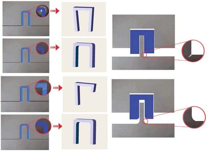

For RIM production, designs should have rounded rather than sharp corners to reduce the possibility of stresses in a finished part.

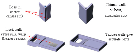

Injection molds are filled by the movement of liquid resin within the closed mold. Uneven wall thickness can lead to premature resin cooling in thin areas, so it is important to maintain uniform wall thickness. It is possible, though expensive, to fashion traditional steel molds with conformal heating channels to slow resin cooling, allowing non-uniform wall thickness, but this is still considered a departure from ideal design. Rapid injection molding will accommodate a variety of wall thicknesses, but it does benefit from relative uniformity.
Sharp corners in a design can lead to stresses in a finished part and impede mold filling. You can prevent these problems by rounding (radiusing) corners. This guideline is somewhat more critical in rapid injection molding than in traditional injection molding, but is generally easy to accommodate in most designs.

Because resins vary in their properties, some designs are more suitable to one resin than another. For example, due to differing shrink characteristics, polyurethane may be used to produce relatively thick walls without sinking, whereas nylon would sink in the same application. Successful rapid injection molding depends on choosing appropriate resins for the design or designing to suit the resin. Traditional injection molding can sometimes, for a price, be made to accommodate less-than-ideal resins for a particular application. But with the range of resins and resin blends available today, this should rarely be necessary.
Resin characteristics may influence a design that is to underogo rapid injection molding. For example, polyurethane resins are good choices for molding relatively thick walls without shrinking or sinking, whereas nylon may sink.
