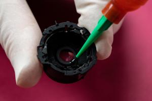

Master Bond UV15X-6Med-2LV is a UV curable, non-cytotoxic adhesive that features optical clarity and abrasion resistance. Not only can it be utilized for bonding, but it can also be employed for sealing, coating, and encapsulating purposes.
