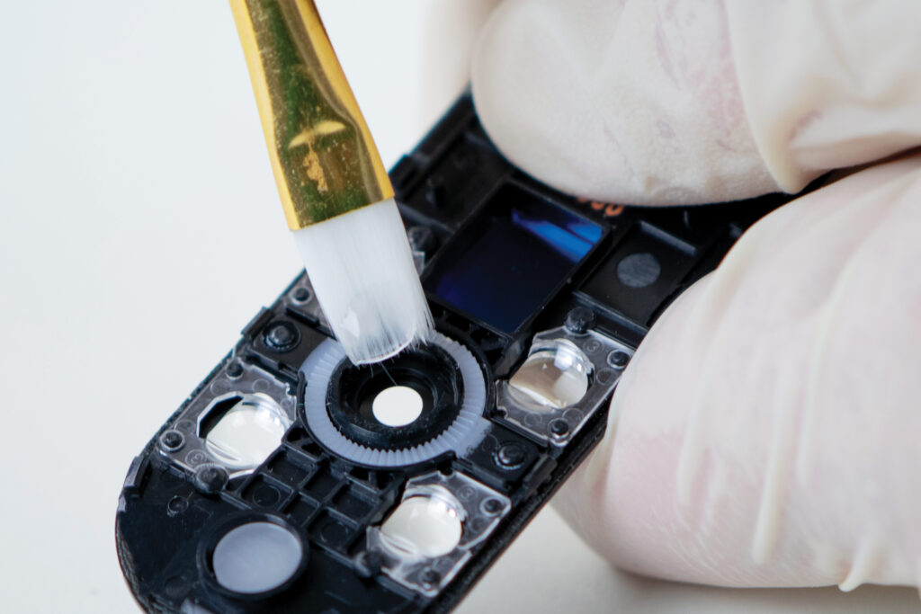

Master Bond UV15-7HP is a low-viscosity, easy-to-apply, one-part, UV-curable adhesive system. Optimal adhesion is achieved in bond line thicknesses of 0.001 to 0.003 in., and it can cure rapidly with a minimum intensity of 20 to 40 mW/cm2 using a UV light source emitting at a wavelength of 320 to 365 nm. The material can also be cured in sections up to 0.125 in. thick under appropriate conditions, making it suitable for bonding, sealing, coating, and encapsulation.
UV15-7HP bonds well to a wide variety of substrates, including glass, ceramics, metals, and many plastics, such as polycarbonates, acrylics, and polyester films. Image: Master Bond
