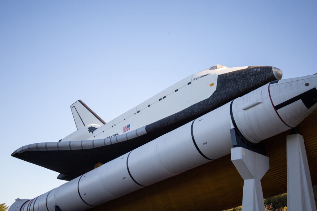

SABIC recently announced the company’s collaboration with Branch Technology to develop lightweight panels to restore the exterior of the Pathfinder, an early test article for the NASA space shuttle orbiter. Branch Technology used its cellular fabrication (C-Fab) process and SABIC’s advanced LNP THERMOCOMP compound to robotically 3D-print a matrix structure that forms the core of its BranchClad composite panels.
These panels were selected by the U.S. Space & Rocket Center in Huntsville, Ala., for the restoration of the Pathfinder prototype. After being installed on the original airframe, the 516 panels were painted to resemble the Discovery space shuttle. The Pathfinder is displayed as part of the museum’s space shuttle propulsion stack. The 121-ft-long Pathfinder, built in 1977 and originally called Orbital Vehicle-098, played a role in testing critical aspects of the Space Transportation System, including heavy lifting, transportation, and ground crew training.
SABIC collaborated with Branch Technology to develop lightweight panels to restore the exterior of the Pathfinder, an early test article for the National Aeronautics & Space Administration (NASA) space shuttle orbiter. The restored Pathfinder is displayed at the U.S. Space & Rocket Center museum in Huntsville, Ala.
In addition to design freedom, the 3D-printed BranchClad panels used on the Pathfinder provide a strong strength-to-weight ratio and help reduce production time, material waste, and cost.
SABIC’s LNP THERMOCOMP compound was chosen by Branch Technology for its 3D printing needs due to the material’s strength and stiffness, which are essential for optimizing the dimensional stability of the open matrix structure. In addition, the compound features a property called self-consolidation, which causes it to amalgamate after printing. Self-consolidation causes a tightening and straightening of the links between nodes in the matrix, resulting in greater rigidity and overall structural strength.
