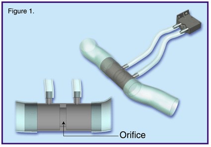

Here is a typical MEMS flow sensor bypass set-up.

A basic bypass set-up consists of two ports inserted into the main flow path with an orifice or some other type of flow restrictor between them.  The restriction in the main flow path causes the flow to follow the path of least resistance into the bypass channel and through the flow sensor.  The pressure drop over the sensor needs to be greater than or equal to that between the bypass ports.

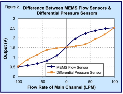

This chart illustrates the signal resolution of MEMS mass flow sensors over differential pressure sensors, even at very low flow rates. At flow rates close to zero the dP curve flattens out making it difficult to distinguish low flow readings from no flow or negative flow.
In the design of a bypass set-up, you need to consider the flow rate, the distance from the main flow path to the flow sensor, the diameters of the main flow path and the bypass tube, and the amount of restriction and shape of the flow restrictor.  The design of the flow restrictor not only affects the created pressure drop, it can also assist in straightening the flow or make it more laminar.  Turbulence in the gas flow can result in unstable readings.  You can use computational fluid dynamics (CFD) software to correct for turbulence.  Some sensor manufacturers are able to provide this service for their customers.
