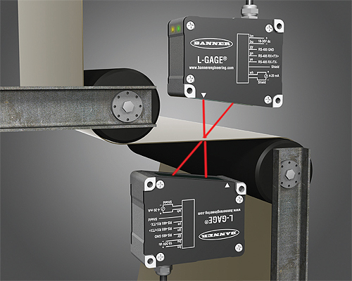

Banner-L-Gage-laser-sensor
Adapts to Changing Targets
Automatic laser power and measurement rate control ensure reliable measurement under changing or challenging target conditions.

Configurator software can provide step-by-step actions to set-up unique measurement applications, such as using one sensor for displacement measurement, or pairing two sensors for a thickness measurement. For example, to obtain thickness measurements, two laser sensors self-synchronize together, requiring no external controller to adjust the sensors’ measurement rate or to calculate the thickness. The measurement data is communicated through a serial communication output, which is then displayed on the PC through the software. The thickness measurement can also be directly consumed as a 4-20 mA output for use in a PLC or data acquisition card. By providing graphical images during each step—including placement of wiring and connections in relation to the position of the sensor—the software enhances sensor usability. Advanced applications including a network of sensors for a mixture of displacement and thickness measurement is also possible.

thickness-measurement
Thickness Measurement
To obtain thickness measurements, two laser sensors self-synchronize together, requiring no external controller to adjust the sensors’ measurement rate or to calculate the thickness.
The second application category is error-proofing, such as inspecting metal thickness before it is inserted into the stamping press. To prevent damage to the stamping press and to avoid making bad parts, the operator has to load the correct sheet metal thickness into the press to create the exact part. A pair of laser sensors operating in synchronous mode can measure the thickness to ensure the correct material is loaded to preserve continuous and high quality operation. Another example of error-proofing is seen on assembly lines. A laser sensor is used to inspect for a missing part or to measure an individual component to ensure each element in the assembly has been installed correctly, resulting in a consistent stack height at a critical inspection point. This not only guarantees product quality, but also limits potential costs associated with the re-work or repair of missing or incorrect parts.
