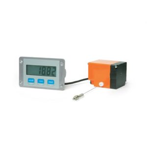

MA508SG – Measurement display with wire-actuated encoder
In addition to the already known instruments for measuring lengths, angles, rotational speeds and inclinations, the SIKO GmbH is now offering a new meter with an attached cable control that can be used for a variety of applications. The measurement display unit MA508SG measures distances of up to 2000 mm in length and immediately shows the measured distance with a resolution of 0.1 mm in the display that is spatially separated from the wire-actuated encoder. The advantage of this is that, in principle, the meter can be mounted anywhere on the machine. In other known devices, the measuring length is 1000 mm.
Sophisticated, durable magnetic measuring technology
A magnetic ring is integrated in the wire-actuated encoder to emit the signal. The impulse that is emitted from the magnetic ring is translated by the measuring device into the correct distance information and sent to the display. It can be used in applications with areas to be measured of up to 2000 mm.
Compact and proven
The new measuring display unit MA508SG with a wire-actuated encoder from the MagLine product range is impressive due to its innovative and, above all, proven technology of the well-known MA508 measuring display unit and the SG10 wire-actuated encoder that has been selling very successfully. The compact size of the two components allow for a problem-free constructive integration, even in installations where space is restricted.
Push button operation
The measuring display unit can be set to zero or to a pre-defined offset value at the push of a button. Other parameters can be programmed by using an external programming device called ‘PTM’ that is connected to the unit through the programming input port.
