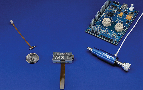

SQUIGGLE-piezo-motors
Since 2006, SQUIGGLE piezo motor systems have shrunk in size from (at right) a 12 mm diameter motor with 51 x 76 x 14 mm drive card, to (at left) a 2 x 2 x 5 mm motor with a flip-chip drive ASIC (shown on the dime). This enabled the creation of integrated micro-mechatronics modules such as the M3-L module (center) – complete closed-loop motion systems in housings of less than 7 x 12 x 30 mm.

The last five years have seen impressive miniaturization of piezo motors. One example is our SQUIGGLE motor. Recent innovations have yielded dramatic reductions in the size of the drive electronics. Such reductions were possible in part through collaboration with TDK-EPC to develop new, lower-voltage piezo actuators and eliminate the need for voltage boost circuits; and in part by work with analog IC experts at austriamicrosystems to incorporate more intelligence into the piezo drive ASIC.
These advances enabled new integrated micro-mechatronic modules: small closed-loop actuators that serve as simple “drop in” subsystems in OEM product designs. The system designer provides high-level commands to the module through a standard serial interface. A 3.3 Vdc battery provides power. The mechanical coupling is customized to the application: to move a lens, adjust a grating, push a valve, and so on.
Such micro-mechatronic modules typically provide as much as 50 grams force with precision of one-half micron and closed-loop accuracy measured in tens of microns.
