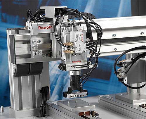

A clean design balances mass and motion: sturdy, durable framing withstands years of vibration and shock, combined with lighter-weight components helps to reduce mass and enable the use of smaller motor/drive components.

Good mechatronics design starts with good mechanical design – the best electronics and electrical systems cannot compensate for poor mechanical design. The most successful designs are “clean.” They feature a strong, rigid frame, using materials and structural principles to ensure that, whatever motion the machine undergoes, its long-term stability is “engineered” in.
Make sure that rigid bearings and support are used where motors are mounted on machines; this helps prevent shafts from being sheared off due to microfractures that occur because the motor shaft is mounted out of alignment with a pillow block bearing or gearbox input planetary gear. Place motors on the machine in the best location so that operators aren’t accidentally stepping on cables and connectors and causing damage; and design machine guarding with easy access points to get to motors mounted under the wing base of the machine while still protecting them against harsh environments.
Most importantly, a clean design balances mass and motion: sturdy, durable framing that withstands years of vibration and shock, combined with lighter-weight components for the moving parts of the machine. This combination helps reduce mass, delivers more energy-efficient motion, and makes it easier to size-up smaller motor/drive components for the machine. We’ve seen a lot of very innovative mechanical machine designs over the years, and a clean design makes the largest contribution to a machine’s longevity, robustness, and lowest overall cost of ownership.
