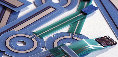

membrane potentiometer
Membrane potentiometers can solve many of the problems that conventional mechanical potentiometers cannot handle, especially those involving limited installation space, weight restrictions, and accuracy.
Conventional mechanical potentiometers are the old workhorse of electrical controls and position sensing. However, these conventional potentiometers can be heavy, bulky, and expensive compared to a newer type of device, the membrane potentiometer.
With some measuring only 0.5mm thick, ultra-flat membrane potentiometers are comparable to conventional potentiometers in terms of electrical parameters, but can be used in applications with limited installation space and at a lower cost.
Because most producers of membrane potentiometers offer customized products with only small tooling efforts, costs are very competitive, even for small prototype quantities. Three additional advantages are found in the basic construction of the membrane potentiometer; its ability to be fully sealed, the possibility of a hollow shaft design, and numerous wiper options, including operation by hand.

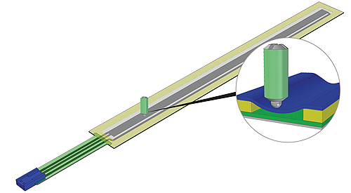

wiper
The wiper covers about 10 to 50% of the active width on the membrane potentiometer. Typical wiper materials can be steel, brass, or a variety of hard plastics.
The wiper for the membrane potentiometer can be as simple as a small plastic knob sliding across the surface, requiring no external electrical contact. Most membrane potentiometers can also be operated by sliding a finger over the surface or even with a contactless magnetic design.
The spacing adhesive requires a minimum width of 2 to 3mm on all sides of the membrane potentiometer. The ideal width of the resistive active area should be between 3 and 6mm, but can also be extended to 10 or 12mm. Linear elements can reach up to 760mm in active length, while rotary elements with a central hole can measure from 20 to 450mm in diameter.
The life cycle and operating temperature correspond to those of mechanical potentiometers. Depending on the design, however, even up to 100 million operations are possible. The operating temperature can range from 40°C to 85°C (104°F to 185°F), with some models achieving a maximum temperature of 125°C (257°F). The design of membrane potentiometers makes temperature compensation unnecessary if being operated in a voltage divider mode. Electromagnetic interference will also not affect the system.

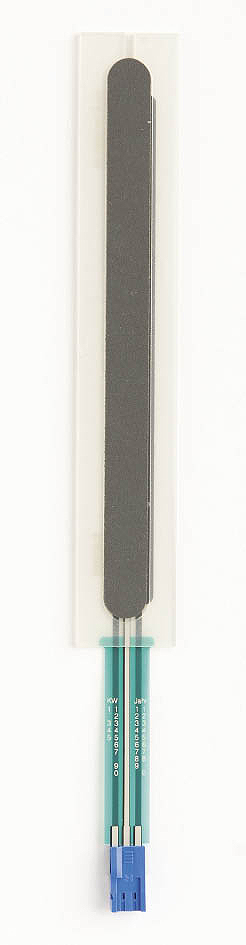

typical-membrane-potentiometer
A typical membrane potentiometer is only a razor-thin 0.5mm thick and can have a width from 8 to 12mm and lengths up to 760mm.
If lifecycle requirements are high, a magnetic wiper is recommended for contactless connection. For most applications, however, a spherical wiper will do. The typical wiper covers about 10 to 50% of the active width. Materials such as steel, brass and hard plastics (e.g. Delron, Delrin) are typical, but depend on the type of membrane potentiometer. The specific manufacturer should be able to offer advice regarding the right choice of material.
Different surface pressures are defined depending on the application, but in general, a range of 1 to 6 Newtons (N) is recommended for most applications, depending on whether the membrane potentiometer is configured in a standard foil layout or in a hybrid version with additional metal bonds to strengthen the structure. A standard off-the-shelf wiper is usually divided between a 1 to 3N and a 3 to 6N range.
