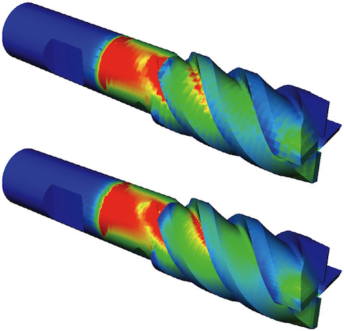

The accuracy of Scan&Solve is a function of the grid resolution. Adjusting the resolution is quick and easy, making it possible to run either conceptual studies or detailed analyses without incremental work. It’s also possible to adjust the grid resolution to see that the solutions converge. This is not too different from traditional FEA, except that it requires no work from the user (other than moving a slider and pressing the “go” button.)
Illustration 2: No remeshing is required to solve with higher or lower resolution. (Top: 10,000 elements, 26 seconds. Bottom: 55,600 elements, 96 seconds.)
No matter what grid resolution setting is used, Scan&Solve will produce an answer. It is deterministic, with no exceptions, heuristics, or meshing error messages. Performance is predictable, and scales linearly with increased resolution of the analysis. (Analyzing the endmill illustrated here took 26 seconds for 10,000 elements, and 96 seconds for 55,600 elements, using an HP Z1 workstation.)

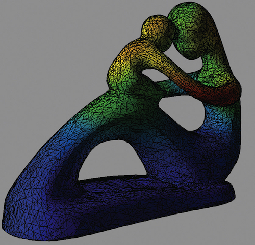

Illustration 3: 3D scanned or reverseengineered models can be analyzed with no meshing required. This model shows the displacement due to gravity on a granite sculpture.

Intact Solutions has implemented Scan&Solve with polygonal models (e.g., STL files), and is working on a project to integrate it with volumetric scanned models. While these aren’t commercial products yet, they give a hint at what may be possible in scanning and analyzing real world artifacts.
