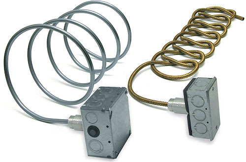

Minneapolis, MN – Minco has a new line of heating, ventilating and air conditioning (HVAC) temperature sensors designed to protect chillers in air handling equipment in commercial buildings. The new sensor line is called the Chill-Out™ Combination Sensor.
Visit Minco’s Total Cost of Ownership (TCO) Calculator to see your true savings if you install both a freeze stat low limit device and an averaging sensor.
Most schools, hospitals, office complexes and other commercial buildings use a device called a Freeze Stat, along with an averaging sensor to protect against freezing temperatures. The solid state, low temperature cut-out Chill-Out sensor has a number of advantages over traditional Freeze Stat/averaging sensor technology:
— Minco’s Chill-Out™ Combination Sensor replaces the Freeze Stat, but, unlike the Freeze Stat, it has two sensors in one easy-to-install package. One is a low-temp
cut-out sensor and one is an independent averaging-temp sensor. This dual sensor package delivers accurate measurements and eliminates the need to install a separate averaging sensor.
— Saves $13K-$35K over a typical Freeze Stat/averaging sensor installation.
— There are no capillary tubes to break, leak or kink.
— Considered a “green” product by the industry as it is solid state and has no harmful gases or chemicals.
— Easy mounting in any direction. Horizontal orientation is not required.
— Relay changes state to deliver a failure detection signal in the event of a power loss.
— Low-temp sensitivity within a 12-inch segment, versus 18 inches with gas-filled capillary tubes.
— Easily formed aluminum or ultra flexible PVC coated galvanized armor sensor case.
— 4 to 20 mA temperature loop output available with optional Temptran™ transmitter.
— No diaphragm case needed.
