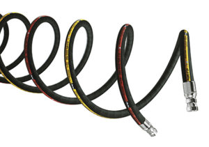

bend-radiusThe minimum bend radius of hydraulic hose represents the smallest diameter that a looped hose can achieve. A hydraulic hose is constructed of three layers, each of which adds to the stiffness of the hose; the tube, the reinforcement(s) and the cover. Depending on the nature of these layers, the bend radius changes.
